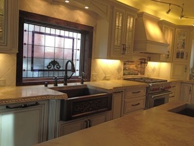

    I wanted to share pics of our finished DIY Concrete countertops. Everyone that sees them , loves them. I did and am still having problems finding the right sealer, but it will work for now and is loads better then what I had. We spent about $600 total on countertops and I still have enough material left over to so several more countertops.

    Another view

    We used an acid stain, 3 actually to jazz it up a bit.

    That is beautiful, Dawn!
  • melissaki5
    9 years ago
    Looks fantastic! How hard were they to DIY? I love the color you picked also - it works really well with the backsplash.
  • jennifer132
    9 years ago
    The countertop looks awesome! Thanks for coming back with the finished project.

    Very nice.
  • dawnk82
    9 years ago
    Melissaki5 actually, they weren't as hard as I had expected, husband and I did them ourselves. He did most of the sanding, then I acid stained them and then sealed them.
    I used an ebony, walnut and amber acid stain and left some of the natural concrete color showing. For the veining look I used a plain ole paint brush.
