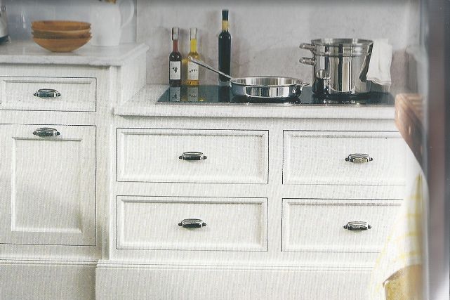

RE: How tall is your toe kick area?
Laura 517, here is a picture of what I intend to do with my toe kick area. I know you can use it for storage, but at this stage of my life I don't want to bend down that far so mine is purely for looks. This base looks a little high and I am guessing it it a good 5-6 inches. Mine will be 4 inches high.
