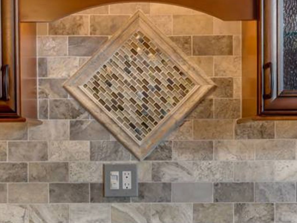

    Here's mine. They are usually behind something, but having found matching outlet covers, I don't mind if they show!
    Mine are 2 1/2 inches over counter, so pretty low. Good luck!

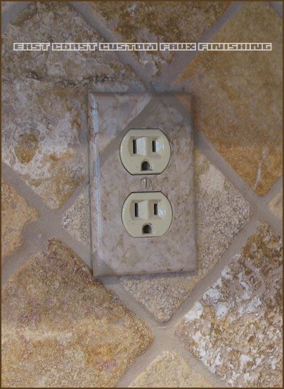

    Mine are all high and very difficult to see--but then I don't have anything plugged in regularly. One of the favorite things I have seen on GW was some faux painted outlet covers. I couldn't find that link but did find something similar
    Here is a link that might be useful: faux painted outlet covers
