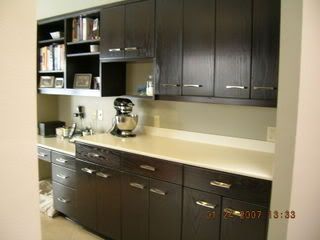

Here is before and after with gel stain
Before: (prior owner there, not me)
1998 side wall
1998 when we bought  the place
And after
two years later
nice winter  lightfrom entry
drawer stack...botoom pull too low
With apologies to those sick of seeing this reposted, here's is my excessively detailed how-to:
GEL STAINING INSTRUCTIONS
It is a very doable project. You just need time, $50 in supplies, and patience. No skill.
Here's more than you need to know:
My cabinets were frameless, good condition and good layout. But the finish had gone orange and ugly, with the oak graining too busy for me. Cabinet were 18 years old, very poorly finished oak veneered slab doors. Plain with no crevices. They didn't even take the doors off to finish them!!! No stain or finish was even put on the hinge side edges. Bad workmanship.
I looked into changing out cabinets, but that was way too much money, since my layout was OK. Painting didn't seem right because the doors were plain slabs. I considered new doors but that still meant a lot of money. For a few years I tried to figure a way to add molding toward a mission look, but the rounded door edges made that impossible. Then trolling in a kitchen emporium showroom this last year I noticed dark wood slab doors, kind of like mine, but darker. That was the answer.

I added smashing hardware, raised my pass-through, resurfaced the Corian (also simple but messy and tedious) and replaced the DW and sink. It looks gorgeous to me and I really enjoy the space - how it sits all quiet, clean and serene, then gets all crazy with the food and folks du jour. I couldn't be happier, especially that I didn't have to work another year just to pay for the update!!
Link to cabinets in progress: http://photobucket.com/albums/b45/celticm00n/kitchen cosmetic upda te project/kitchen during/
Link to almost finished cabinet pix: http://s16.photobucket.com/albums/b45/celticm00n/kitchen cosmetic update project/finished bit by bit/?start=20
It's been about 3 years and I am still very happy with the outcome.
