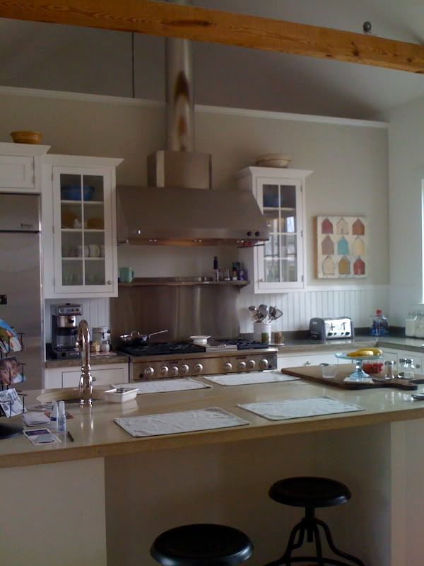

I had forgotten to come back and post photos of our beadboard backsplash. Sorry for that. This beadboard is actually birch beadboard panels. It was installed right over the plaster. My DH finished the top and bottom with very small molding that resembles chair rail molding. I think it finishes it off well without being too bulky. We are very very pleased. Right now it is finished in a satin paint but DH is to seal it with a semigloss urethane or maybe keep it satin, but I can't decide.
Please ignore the plywood windows and also the dogbone on the floor!! Sue
RE: Do you like your beadboard backsplash?
EXCELLENT. Thank you, Sue, for posting these pics! They are exactly what I needed to convince my DH! Thanks again!
