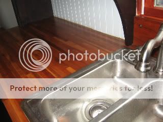

    We have wood around our kitchen sink. It's cherry from Lumber Liquidators and finished around the sink with waterlox. I actually started off with just vegetable oil, but that wasn't enough, the waterlox is amazing. Our home is an 1898 Colonial Revival and it really fits with the period of our home.
