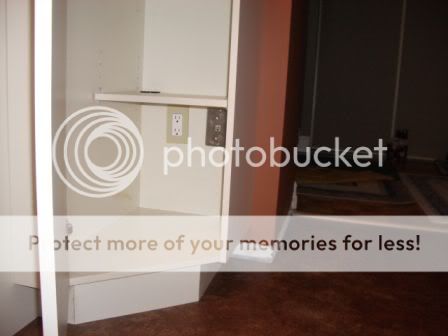

    You won't believe this, but with all this talk about plug mold and not having electrical outlets cutting into the backsplash, I looked under my top cabinets and discovered our fluorescent recessed lights have electrical outlets built right in. I took an appliance to see if they work and they do!!! We've lived in this house 29 years and NEVER knew the outlets were there. I have just reached up and pushed in the button to turn them on and never took a good look at them. Why aren't recessed lights today coming with the outlets installed as part of the unit today? That would eliminate any need for a plug mold.
