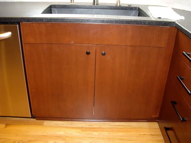

I just measured and it looks like the drive takes up about 4" from the back wall of the cabinet. The drawer box is 19.25" from the back of the pullout box to the front face of the inset panel.
I didn't tell DH about the servo-drive initially because I thought he would be upset by the expense. It just so happens that it is one of his favorite features in the whole kitchen and worth every penny!

kitchen_angst- I'm not sure what you mean by system, but my cabinetmaker made a deep drawer box so the bins would be secure. The dimensions of that drawer box are 15.5" wide by 21" deep by 12"high. I really went to town (literally) looking for the best bins to use for maximum capacity. I wanted the highest with the widest "mouth" that still fit two. These are Rubbermaid model 2806. Funny it took longer to figure these bins out than my backsplash LOL!

faleash, is your cabinet as low to the ground as it looks? looks like not much room of toetick.
I am doing these cabinets which will sit about 1.5" off the floor so I am worried about accidentally hitting them open with my toes or something.. Otherwise I got the approval from the wife to get the parts for the install :)
RE: Hands-free opening for trash pull-out
poorowner- that's an optical illusion... I have standard 4 inch toekick space.
