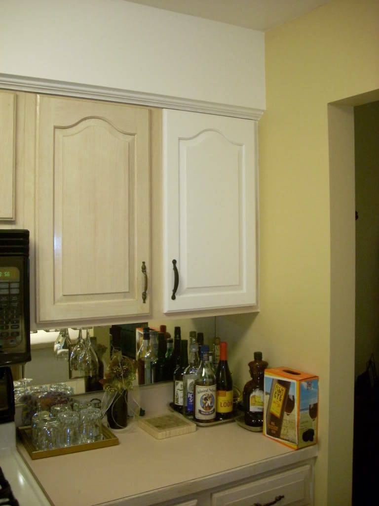

    Yours don't look as yucky as mine do.
    I am doing what Marita did - I am painting them white. Here you can see the new white paint next to my pink pickled oak. I have finally finished the uppers and will start on the lowers tomorrow. I did not fill in the grain. I cleaned, sanded, primered and used 2 coats of SW Pro Classic.

    I also don't mind pickled oak as long as it isn't that pinky color. I actually like robynpa's before cabinet very much. It's not what I would choice but it looks fine to me. The after is fine, too.
