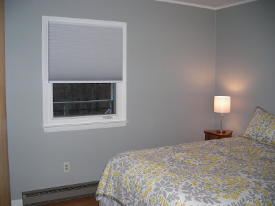

13 years agojpeeps...
Some of us do not come to the forum daily...or even weekly. Sorry you didn't get the timely response you were hoping for. We just laid another 140 square feet of Allure... in a basement bedroom. It went down like a dream. It's been down since before Thanksgiving and so far so good. Original (laundry room) floor has been down 3+ years...and looks like it did the day we put it down.
I paid for a more expensive color this time--the Honey Maple. I am pleased with the results:
At $1.99/sq I'm not expecting it to be a floor for the ages...but it should do until I can afford what I wanted. I just wish we'd replaced the baseboard heater BEFORE we did the flooring. DH didn't want to mess with it. Argh. Luckily, with the furniture back in the room it's not quite as egregiously ugly:
(I still think we need to put in a new heater. A white one.)
