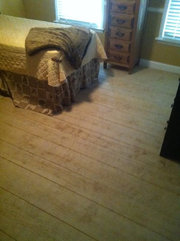

I have a question or would like some opinions on something before I floor my entire upstairs with it. I was browsing through Lowe's and came upon a Knotty barnside "sheet siding" and thought it was be a very cool flooring look. My carpet is funky and needs to come up and I am trying to eliminate all the carpet in the house due to a son with asthma/allergies. Anyway, I am on a tight budget and have about 1500 sq. ft to replace. I laid this siding in one room so far which was very inexpensive and I love the look. What are you thoughts on this and could I put a poly over it to make it hold up to foot traffic? Has anyone ever heard of doing this? If so can u give me the negatives/postives? I've attached a picture.....

Is this the plywood-type material or one of the composites?..difficult to tell from the photo.
Regardless, you could coat either with a quality waterborne polyurethane, such as Bona Traffic or Basic Coating Street shoe...or another comparable professional use product and you would have a durable and cleanable, although unconventional, floor.

Hi! Thank you for your response! This is the composite siding.

How did you install it?
Nailed down? Glued down?
What did you do at the joints?
RE: Has this kind of flooring been done before or should it?
We installed it ourselves...it is tongue and groove so it was really easy to lay. We used a nail gun after we installed all pieces and secured it down. I haven't figured out the joints yet and how I will fill those in...thinking of using caulk?

Something like Traffic will help keep you from wearing off the design layer.
What do you mean by joints?
"Traffic"? Is this a type of sealer? Where can I buy it?
I think the pp meant the seams (joints) ..each piece was 8x4 so my room was 11feet in length so I had to seam my sheets.
Yes, I meant the ends that were not tongue and groove. I have been tiling for the past two weekends so my brain was thinking of a butt joint.
