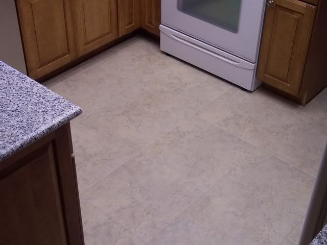

  • suel41452
    9 years ago
    Laurie - your floor looks great with 18" tiles! I think they would work in mine, unless my floor is not flat enough.
  • Laurie
    9 years ago
    Thanks! I forgot to mention that we installed this tile on top of the existing sheet vinyl/linoleum. The vinyl was firmly adhered to the concrete sub floor. We used a stripper/cleanser product on the vinyl before starting this process.
  • susanlynn2012
    9 years ago
    Suel1452, if the floor is not flat, a good contractor can level it for you before installing the tile. So before buying finding a good contractor. I love Laurie's floor in her kitchen so much and her flooring in the rest of the house.
