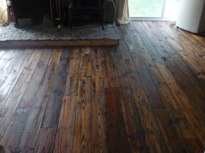

    We just installed wide-board pine, in our second floor this summer (see pic). The wood seasoned inside for 6mos, and during that time I did 3-4 coats of tung oil. I chose to tung oil, because our first floor is cherry with a poly finish. As hard as this wood is, it shows every scratch. We have a dog, cat, 10yrold boy and lots of inside/outside activity. I wanted to be able to refurbish a floor with minimal effort and knowing that scratches are gonna happen, I wanted a floor that would "hide" them fairly easily. So far any scratches that shows up on the pine, I just buff out with some Tung oil and they pretty much disappear. Granted the second floor doesn't get the hard traffic our first floor does, but the oiled maintenance is turning out to be its best feature. Not to mention it still looks really awesome. I am really happy.
  • dan1888
    6 years ago
    Very nice floor. Which tung oil product do you use?
  • portlandmaine
    6 years ago
    last modified: 6 years ago
    I used Hopes 100% pure tung oil. In retrospect, I probably should have cut it with solvents first to allow it to soak in more, but I didn't. The first coat soaked in nicely, with minimal wipe off and took a day to dry. but each consecutive coat had more and more wipe off, more days of dry time. I buffed after each wipe off and sanded between each coat. The last coat took 4 days to dry. This was a labor of love, otherwise I would have really minded that it took 8mos to get my floor in! Plus it really felt like my expensive tung oil was going to waste with all the wipe off. But I did a "stain" test on a sample board with water, and red wine, left it on for about half hour. Wiped off clean with no marks. I just bought a Disco floor polisher attachment for my sebo vacuum, and cant wait to see how it buffs out these floors and plus our well-worn and scratched polyed cherry on the first floor. I'm thinking the pine long term floor maintenance just got a whole lot easier with this oil and the buffer.
    Also wanted to say that we bought this floor from a local mill thru a local flooring company. Our contractor hemmed and hawed about potential poor grade, and pushed for going with a larger known company such as Carlisle. But I relayed my concerns onto the mill and even sent them pictures of what was acceptable for knot size etc, etc. I did shop around, the mill was definately the cheapest and the riskiest (Carlisle the priciest, but best reputation). My contractor was sweating bullets before the install, but when the boards came in he was pleasantly surprised, and now he loves the floor, and probably found a new source for his clients. In all a happy ending!

  • portlandmaine
    6 years ago
    Tung-oiled pine flooring update. It's been a year since my last post in this thread, and a year and a half from the floor install, so I thought I would post an update. Some backstory: These pine wide-boards were sawn at a local mill, kiln dried and I think indoors for abt a year before we got it. The boards sat in our house for 6 months before actual install. During that time, I sanded each board and applied and buffed in 4 coats of Hope's Pure Tung Oil. They were installed on our second floor, all bedrooms. Once installed, I buffed in one more coat of tung oil.
    Today. I am very pleased with how the tung-oil is protecting the floor, and how the floor is holding up. Not seeing much gap between boards, and any accidental spills are not leaving any stains, but I do get to them fairly fast. For clean up, we vacuum and when needed, use damp rag and elbow grease for any scuffs, or marks (dog paws), etc. I occasionally buff out scratches with tung oil (we have a dog and 11yo boy). Since the floor has gone thru one dry winter, this summer I plan buff in another coat of tung oil for more durability. Because it is pine, we do not allow shoe traffic on the second floor or food, but that rule was same when the flooring was carpeted.
    I love this floor! The patina is becoming quite lovely, it has been really easy to keep. I expect the floor to age gracefully and develop more character as the years go on. I do not regret going the all-natural route with using only the tung oil.
