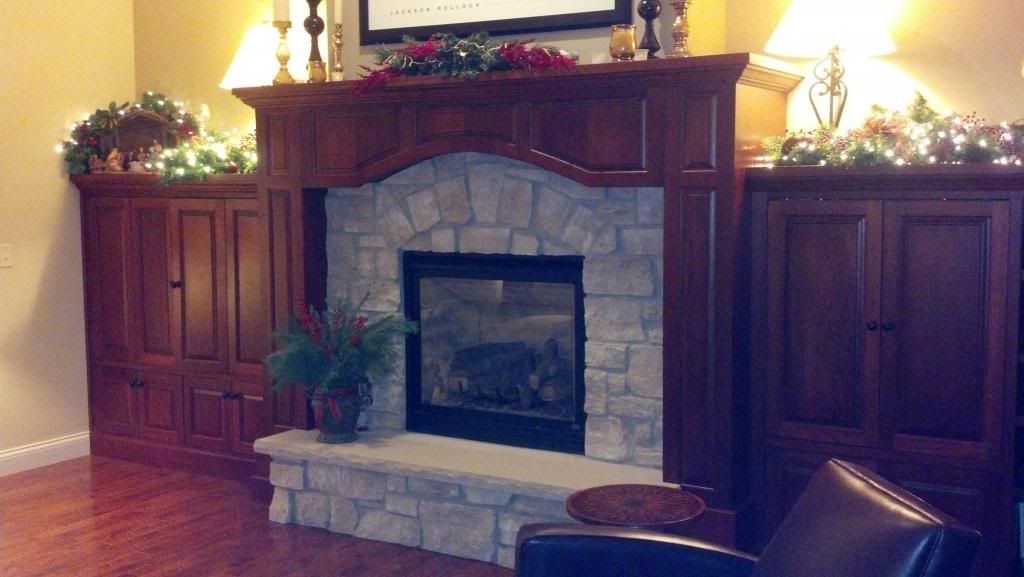

My hearth is 12.5" high. The firebox is 3' wide x 2' high. The surround is 18" wide on either side of the firebox (so, 6' wide including the firebox) and goes to the 8' tall ceiling. The height of the hearth makes a nice bench for two extra butts at those crowded holiday parties ;)
Here's a pic. The room is 18' square with 8' ceilings.
