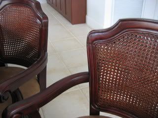

    I used Minwax Polyshades to darken these counter stools. My apologies to those who have seen these photos before.
    Original color and after the first coat.
    The finished stools.

    Ooops, sorry, yes, I do mean gel stains, although the Minwax polyshades results look good, too. On their website, however, they say to use the polyshades on bare wood. Did you sand first to give it tooth? How is the finish wearing on the stools?

    GREAT JOB with the stools Sis3, wow. I have never really understood how the Polyshades works or was different from the gel stain. Our kitchen cabinets are similar to the original color of your stool and I've been wanting to do something with them but DH won't let me just paint them.
    I'm really impressed with what the polyshades did with that color. Can I ask what shade it is and if you know, what the actual difference between the Polyshades and Gel Stain is?

    Thank you lukkiirish! Polyshades is a stain and polyurethane in one. Unlike regular Minwax, or any regular stain for that matter, it is intended to be used on finished wood. The lightest of sanding is all that is necessary just to provide a key for the stain to adhere to.
    The color is Bombay Mahogany, satin finish. I think the secret to success is following the instruction to apply only a thin coat at a time.
    I have used gel stain too but I don't like the way it looks when the sunlight hits it - you can see every brushstroke! Perhaps I should have taken even more care when applying it?
    The stools have been in daily use for 3 or 4 years now and apart from a chip on one arm that I need to touch up, the finish is holding up really well. I don't know if I would have the courage to tackle kitchen cabinets though! I suppose if it wasn't successful you would then HAVE to paint them :-)
