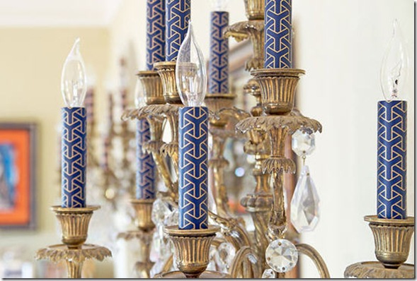

  • jterrilynn
    Try KaarsKoker candle sleeves. For replacement colored glass or crystals check ebay.
    You can get almost any color sleeve you can think of.
  • nosoccermom
    I'm all for painting, but in this case, I'd seriously reconsider and get some more or less funky candle sleeves.
    Here is a link that might be useful: kaarskoker candle sleeves
  • HomeMaker
    I'd paint my shiny cheap chandelier in a heartbeat, but that one looks to be quite a nice old one. Love the idea of changing the sleeves.
    I should try that with mine.
  • nosoccermom
    Great idea by jterrilynn! I never knew these sleeves even existed. I wonder if one could just use nice contact paper or high-end wrapping paper. One could change with the seasons or holidays.
  • Kathie738 P
    I've used wrapping paper,contact paper, even paper napkins with a bit of glue on the seam...buy extra sleeves and try it.

    Yeah, it is old and heavy it may date back to the 1940's or possibly be even older (her dad's) for all I know. I love the candle covers! What a great idea!
