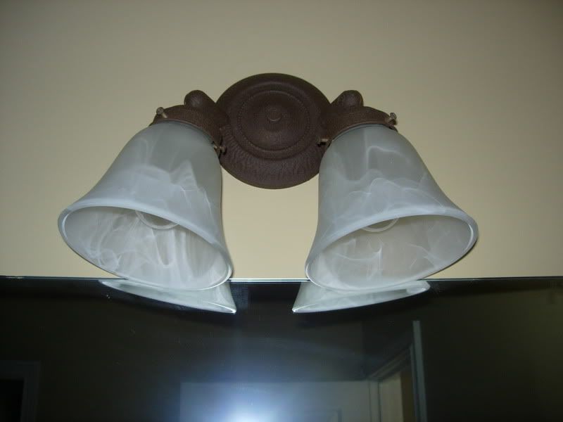

  • printersdevil
    16 years ago
    I painted a hall vanity bath light in the Rustoleum in the brown color. It looks like the one shown here but I don't remember the name. It matches the new ceiling light that we put in there and save me some $$.
    I am very interested in the name of the paint and color of the ones that look like the oil rubbed bronze. I have several standing shiny brass lamps that I love except for the shiny brass. I think I will try to paint them. But I don't want them as brownish as the one in the bath room. ORB look would be great.
