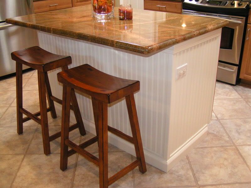

DH and i finally got around to finishing off our kitchen island. Well, it's not 100% finished yet, we are still going to frame out the bead board and possibly do corbel's on the corner of the island to give it a furniture look. Here are some before and after pics.....
Before......
During....
After...
Closeup....

    cg16 - I found her photo by clicking on that very first photo in this thread and going to her album. Here's the updated island.
  • cg16
    15 years ago
    Thank you so much! It's gorgeous!

    Not sure if all of you know the history of us doing a DIY Beadboard island but when we originally had the kitchen remodeled 5 years ago we were trying to budget and to finish off the island with cabinet paneling it would have added alot more to our costs so decided to just go with the plane ol' paneling to match the cabinets. We decided to finally get a quote of what someone would charge to beadboard and paint the front part of the island an off white color. We got some estimates and got an average quote of $1500. DH said "NO WAY are we paying that much, we can DO IT OURSELVES". So off we went to Ganahl Lumber and found the slated beadboard, bought a new brad nailer and got to work.
    We figured out our surface area we needed to cover and cut the slats to 36 inches (height of our island). We used BOTH glue and nails to attach the beadboard to the island. This came at the advice of the friendly associate at Ganahl. DH and i finished the top and bottom with a decorative molding we both agreed on and used corner molding to easily finish off the corners and found trim that was about an inch wider than the moulding to place behind the moulding in order to rest the corner pieces on seemlessly.

    Here are a couple close ups. Still trying to get my camera adjusted so sorry if the coloring is off. BTW DH finished of the ends with a 45 degree angle.
