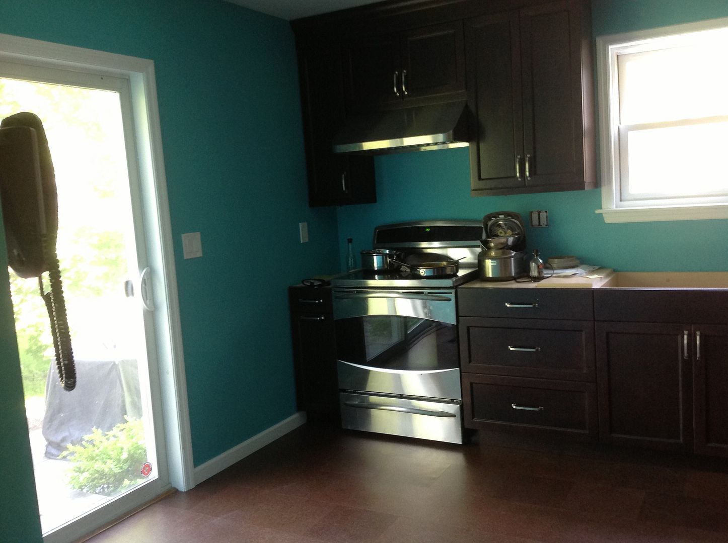

    If you actually cook, I'd go for 22 in. The capture is much better. I have a smallish kitchen and I don't really notice the extra depth looking at it, it's much sleeker than the bulkier looking, but not as deep, OTR MW that it replaced! If it's got a small overall profile it won't take away from other areas.
    Best angled pic I have, looks like I really need to take finished pics!

    Williamsem, thank you for taking the time to reply as well as post a photo. That helps to know that 22" doesn't seem "in your face." By the way,I love the colors in your kitchen, very rich. The deep turquoise, dark woods and SS are a good combination.
