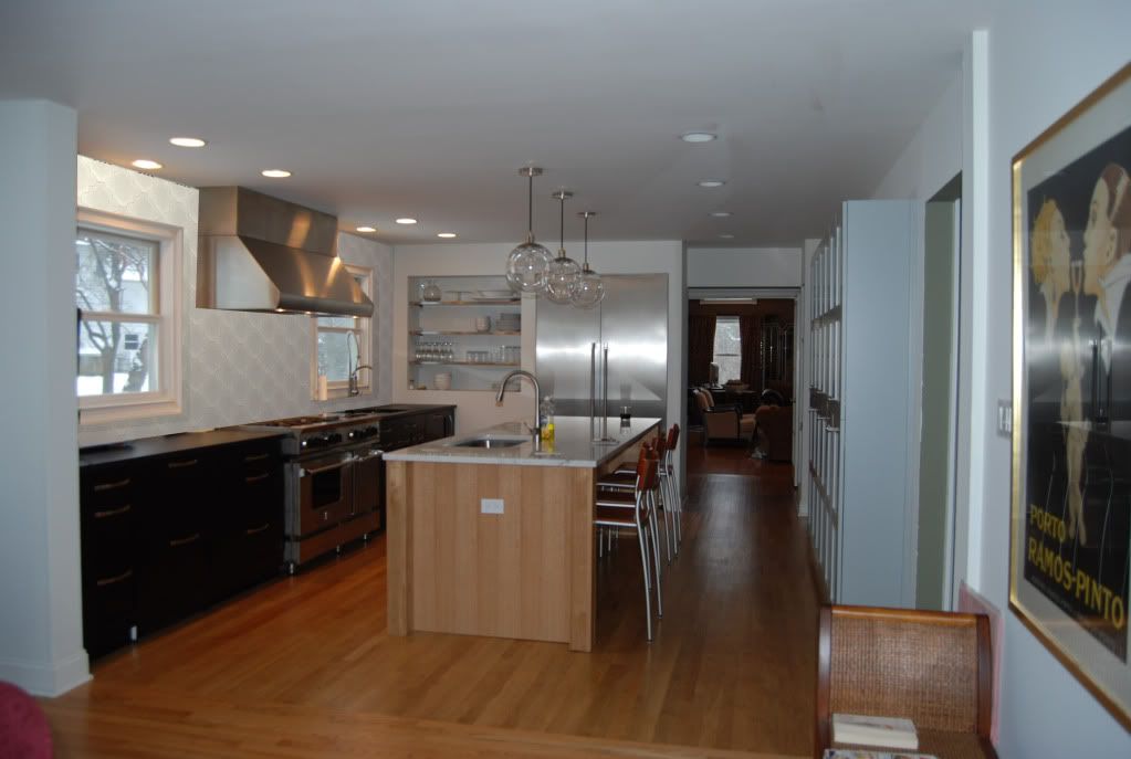

  • malhgold
    14 years ago
    the floors between our kitchen and family room run in a different direction. There used to be a half wall between these rooms and we removed it after we had already installed the kitchen floor. I didn't want to deal with having the family room floors woven in, so we just decided to run it the other way. Aside from the fact that it caused me some design issues for our kitchen reno, it doesn't bother me in the least. The LR that is behind the wall with the print also runs the same direction as the FR. BTW...while not too noticeable in this pic, there is a color difference between these 2 rooms because the floor guy who installed the red oak in the FR didn't "realize" that the kitchen was white oak.
