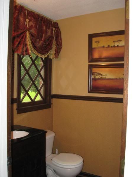

    Actually, I've done exactly that in a few places. I did it on our grooved paneling so I could wallpaper over it. I used cheap latex painters caulk and a putty knife to smooth it. It took two layers because the caulk shrunk and wasn't flush after the first coat. I think you could probably caulk and just paint instead of wallpaper, but you would have to do a neat job and it might be a bit tedious. I just piped it in, ran over it with a putty knife, and moved on without having to wipe up the excess that squeezed out unless it was bumpy.
    You might be able to apply a thick paintable wallpaper directly over the paneling, or with maybe just one quick coat of caulk. They have great patterns as well as simple rolls that look like textured drywall.
    Here's a before and after of one of my projects:
