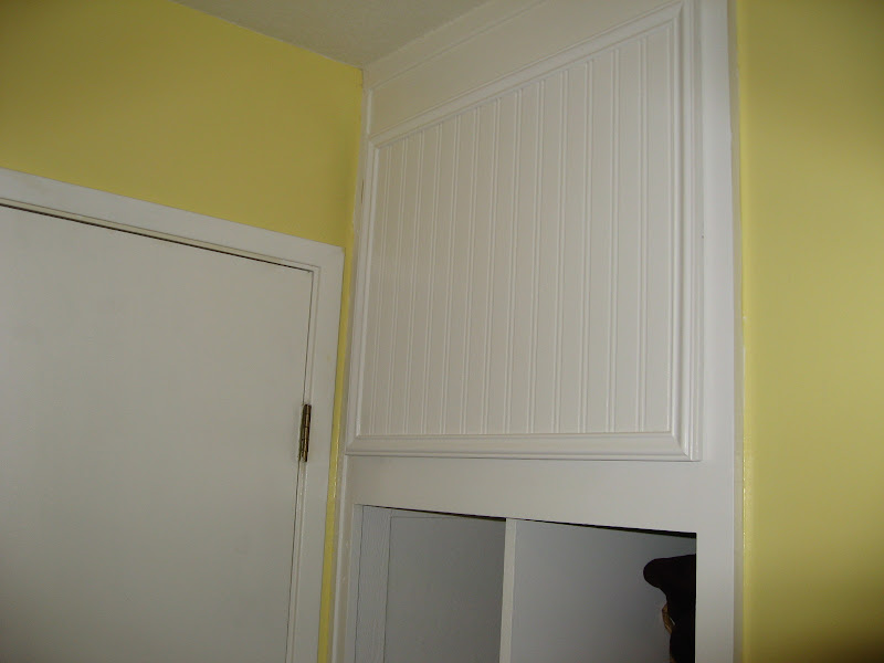

My son and I spent the weekend refacing cabinets in the laundry room and upstairs hall using sheesharee's inspiration post as a starting point. I purchased wallpaper that looks like beadboard, some moulding, spackle and wood glue, and a $25 miter saw from Craig's List. I had some leftover semi-gloss (KM Swiss Coffee). I did the wallpaper and paint while my son handled the miter saw. We didn't have enough clamps to glue the moulding to more than one door at a time, and since the glue took 30 minutes to set it all took a while.
The steps are all documented in sheesharee's link below, as well as in Rhoda's blog that she's linked. If anyone has any questions I'll be glad to answer them
It's not a perfect job, but we're very happy with the change from boring to polished.
Still to do: some touch-up painting of the woodwork, add door knobs, and repaint the walls of the laundry room.
Before - boring doors:
The laundry chute door:
After wallpaper, adding moulding
After:
Laundry chute door:

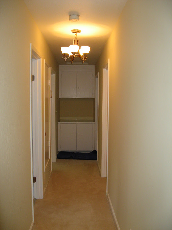

I forgot to add this last picture of the upstairs hall (before). We're not done with this yet, will finish it tomorrow.

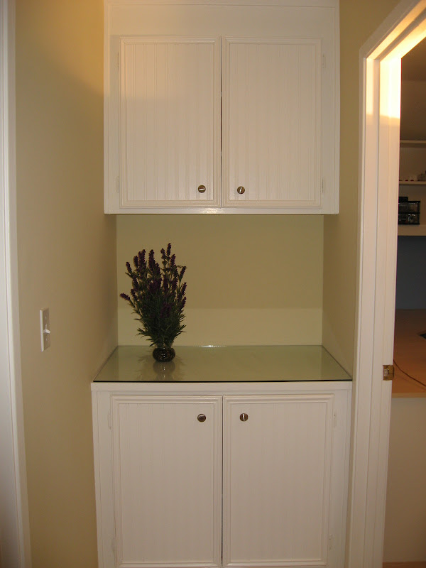

It took a little longer than I had hoped, but I finished the hall cabinets this afternoon, maybe... Looking at this picture it seems that the frame might need a third coat (it wasn't primed).
I've spoken with the manager of a prefab granite place and can get a remnant cut to fit the top of the cabinet for only $65 ($50 for the granite and $15 for the cut). I need to create the template to bring to them, and also bring a larger sample of the wall paint to make sure the color works.

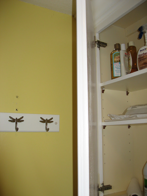

Annkathryn do you have a photo of the side/edge of one of your cabinet doors? We have laminate cabinets I would love to trim with molding but I am not sure how the edges would look. Did you have to fill in the "crack" between cabinet and molding with some kind of wood filler before painting?

Hockeymom I'll take a picture of the edges and post it. You can kind of get an idea by looking at the picture above with the clamps. I glued the moulding on flush with the edge of the door. On one of the doors I think the moulding went a little over the edge because it rubbed a little against the door next to it when we rehung them. So my son sanded both edges a bit and I had to repaint, but it was fine. I did fill in the seam between the moulding and the original door. I used spackle pretty liberally, let it dry overnight, then sanded the next morning with an electric sander to get it smooth. I think Rhoda used caulk. Any place I missed got filled in pretty well with paint. It was a little easier to have the wallpaper go almost all the way to the edge of the door (that happened on the hall cabinet doors, but the laundry room doors were too wide for a single sheet to go entirely edge to edge).

Hockeymom here's a picture of the cabinet edge. My camera doesn't take very good close-ups, sorry. You can see a slight line between the frame and the cabinet. That line could probably be made invisible by a more skilled woodworker. I didn't worry about it too much because you can't see any of the edges straight on due to how the walls are around the cabinets.

Thanks so much! I really appreciate you taking the time to get a pic for me. It looks great from the photos! Unfortunately we don't have any skilled woodworkers around here but our cabinets couldn't possibly look worse than they do now. I'm going to show DH and see what he thinks.

One last picture with the prefab granite remnant on the upstairs cabinets. The granite is called "Golden Nugget".

Looks great! Just wondering, what is the purpose of that cabinet? End of the hall seems like a strange place for a built-in. Is it near the laundry or something?
RE: hall cabinets.
Good question! The previous owners installed it. The shelves are lined with cedar and I use it for sheets on top and blankets/pillows/bedspreads on the bottom. There's no other linen closet in the house. The laundry room is on the first floor and this is upstairs at the opposite end of the house.
RE: My weekend beadboard wallpaper project/laundry room (pics)
Well, that makes sense. I guess they put the counter in for folding.
