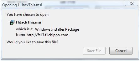

Hi SARose,
Zep (my boyfriend) stepped away from his desk for a moment and asked me to point out that if you continue to have problems with the download, that once you click on the blue letters you may have to patiently await a binary box to pop up that looks like the box below:
HJT install binary box
When the binary box finally pops up, just click on the Save File button to install HJT.
He'll be back in a moment to further assist you. I'll be here also if he doesn't get back in time to help guide you.
Donna :)

Hi SAR,
I never could get Hijackthis to work on my Windows 7 home Premium machine either. I gave up on it. It's possible 2.02 version may run on yours. The only version that runs on mine is a very old version 1.9.
If you want you can try the old version from the link below.
That link below is a binary file meaning it will open on this web page. All you do is click save file when the window opens. Save it to the desktop, go to the desktop and double click it to install it. Once it's installed and the Icon is there, that's when you right click it and select Run as administrator. If you still have the other version remove it so there is no confusion.
Here is a link that might be useful: Hijackthis 2.02
