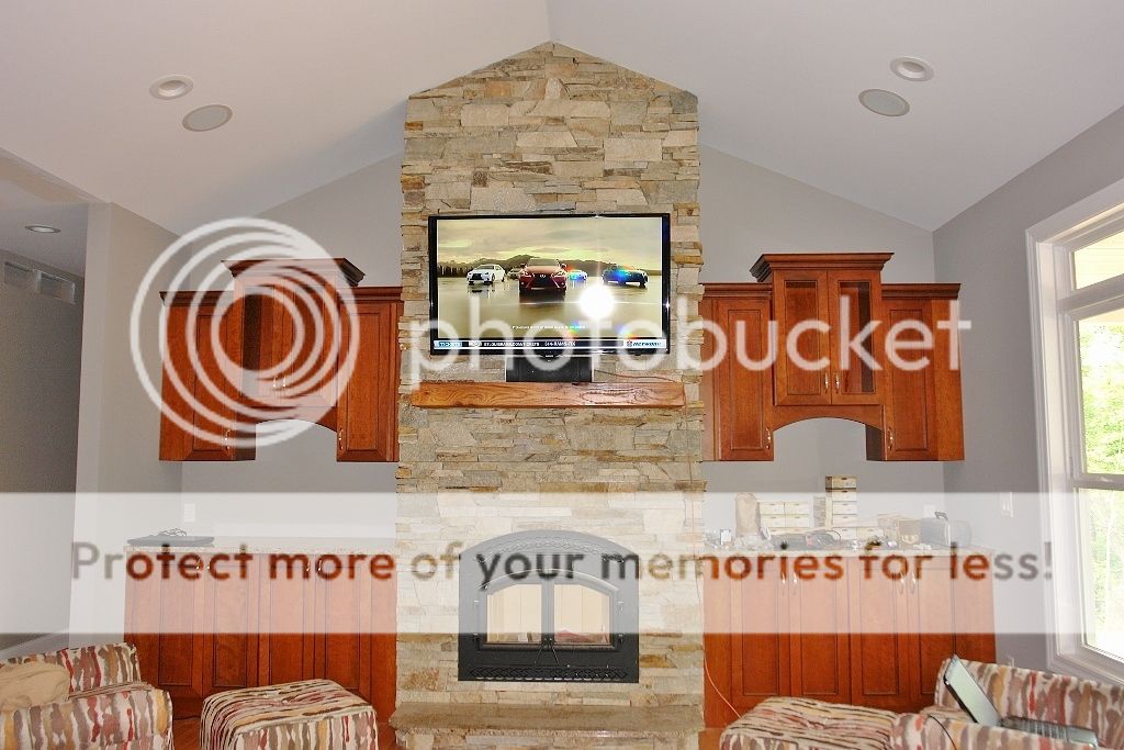

    Something like that Heatilator Constitution model is what I'd love in our new home, but for my wife there is still too much metal showing. Anyone know of a similar unit that still has an integrated blower but with perhaps a bigger firebox and less visible metal?

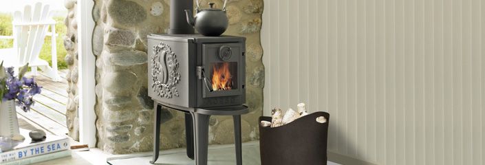

    Annie- That's a nice stove! I'm looking for a smaller version, kind of in between yours and the little one I posted. Just enough to heat up an area of the house, not the entire home :)
  • olivesmom
    Lavender - you need to look at the morso squirrel (there are several models with the squirrel I think) It's small and adorable! It's the one I want!

  • lavender_lass
    Cute! Thanks for the picture :)
