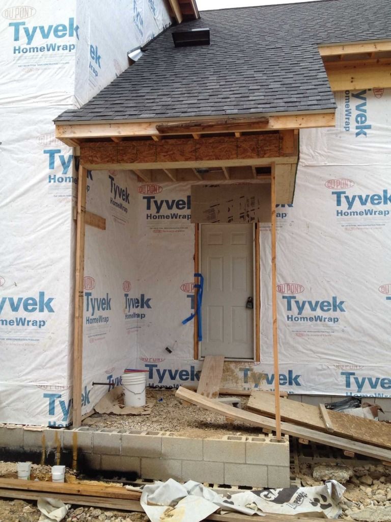

    Rollie, how do I know if we have thru wall flashing? The brick was put in front of tyvek and there was flashing above all doors and windows.
  • rollie
    A thru wall flashing is a metal or membrane flashing that integrates into the weather resistive barrier to bring water that gets behind the brick back to the surface.

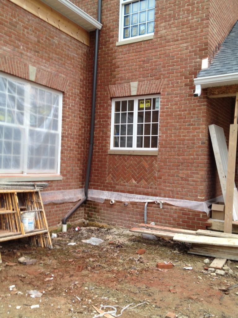

    Do either of these photos indicate we have thru wall flashing? I don't have other, more detailed photos of the brick-to-shingle areas prior to the brick's installation:
