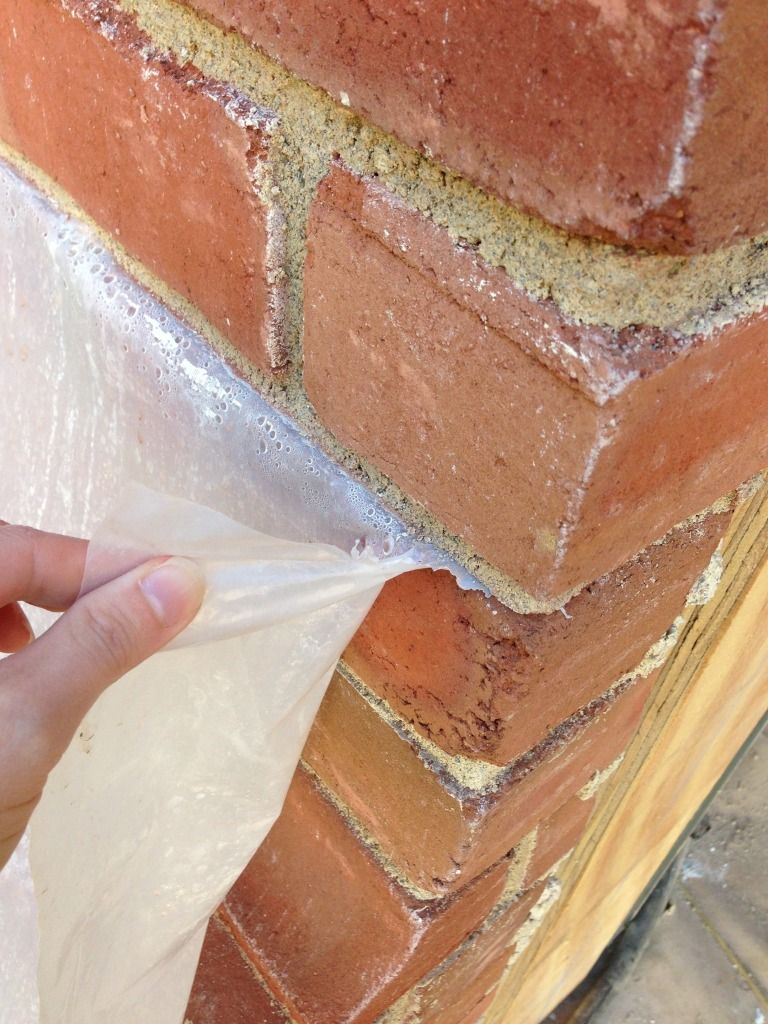

our masons put this sheet of plastic in the mortar above the water table around our house so that the mortar dropping from above didn't get all over the brick. since the house is still not done being bricked this plastic has been there for a few months. will removing it in the spring cause a gap under the mortar to let water creep in? can we squeeze mortar in there somehow to make a tighter seal? any thoughts?

    Mortar is not waterproof; it's function is to support the bricks and bond them together.
    Raking the joints back instead of tooling them encourages water to enter the cavity so obviously the designer was not concerned about excess water in the cavity. If the plastic doesn't go far enough into the brickwork to break the bond, the wall should function as designed.
    Make sure the weeps at the bottom of the brickwork and the tops of openings are clear so water can get out. They should be checked once a year.

    Ok. The mason told us this kind of joint was best to protect against water damage because it compresses the mortar. This is so frustrating! It's hard to know if they know what they're talking about
    How do we check to make sure the weep holes are clear?

    A compressed mortar joint is certainly the best for weather resistance and would have a smooth steel tooled surface instead of being rough like yours. Also, the most weather resistant shape is "concave" instead of "raked" like yours. See the descriptions on Wikipedia linked below.
    Brick joints for private residences are usually designed for appearance not weathering.

    The mortar joint is not so important if the cavity and back-up wall was constructed properly. That is the real weather barrier; the brick acts like a screen.
    When building a house, if you are not extremely knowledgeable about design and construction you must put your trust in the designer and builder; second guessing everything is a killer. If you find it difficult to turn the project over to the contractor you should hire a professional to represent you from beginning to end.
