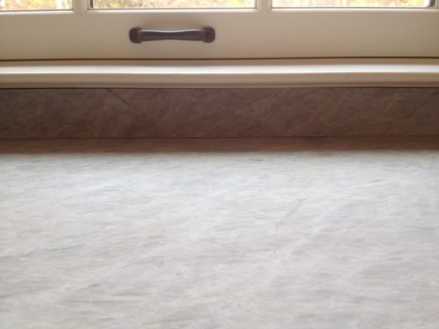

I usually put the stool directly on a 6" backsplash and, when possible, let it be a shelf beyond the windows. I like the window to be part of the counter design not just in the wall above it.

Renovator8, very interesting idea--thanks for the photo!

I wanted to do what Sherrilea did but chickened out. We were worried about water getting into the window frames. Is that a problem for you, Sherrilea? Instead we raised the window 2 1/2 inches off the counter, similar to what Renovator8 showed.
We just put a 2 1/4" strip of the granite as a backsplash underneath.

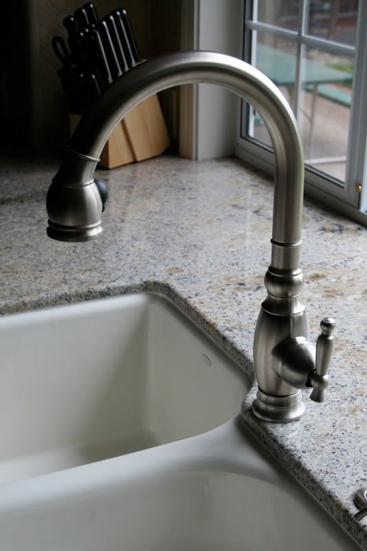

buckheadhillbilly,
With the setup in the picture, are you able to reach the water without bending towards it?
In our current house, while doing the dishes, I am always bending a bit and would like to avoid it in the next house. I was thinking of getting a sink just like yours...
RE: How many inches is best between counter and window in kitchen
aj33, I'm sorry for the delay getting back to you. We've been moving in. I don't think I have to bend any more than at my old sink. I think the key is to have the sink the right height for you. When you undermount a sink, it makes the bottom of it lower. I "test drove" many farm house sinks in the show rooms that were so deep that you would end up with an awful back ache at the end of a good wash up.
I actually picked up my sink at the scratch and dent section of Ikea. I was considering undermounting their sink and wondered if it was really big enough. This one had the back lip broken off and was $25. I figured it was worth $25 to see if it would fit my cookie sheets, roasting pans and other large items. Then my builder pointed out that if I planned to undermount it, the broken bit on the back wouldn't matter. So, after I determined that it was big enough and deep enough without being too deep, we took a tile saw and sawed off the back.
