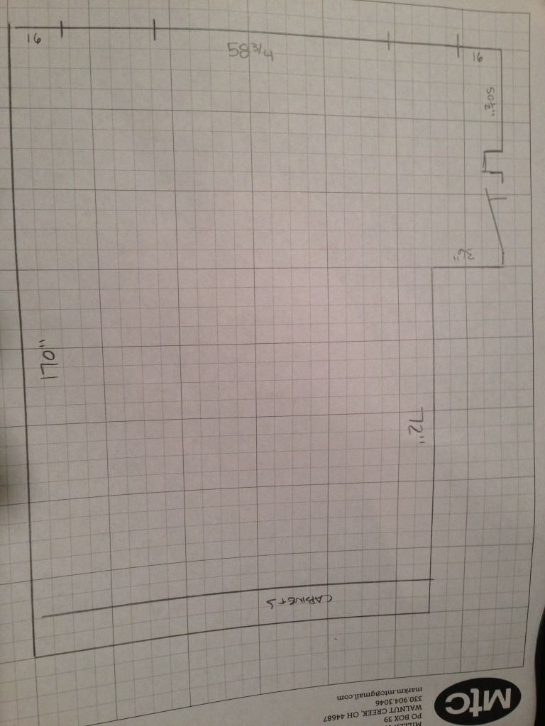

My trim guys want to make a drawing of the library paneling on the wall for me to approve. One wall in this room will be cabinetry, another will be a window, and one will be the door. So, I have two areas where I need to determine how many "panels" to do, one area that is 71 inches long and another that is 170. Also, should the panels correspond to the coffered ceiling or the wainscot below, or be independent? I have no idea how to figure this out and need to give them an answer within 48 hours.Uploaded with Snapbucket

I would refuse to answer this question in 48 hours, even if it meant some delay. The coffers and panels should relate to each other. You should 1) google some images for panelling for your house style to get some idea of what you like and 2) show it to your carpenter who should be able to make suggestions in keeping with the home, the cabinets, etc.
As it is, I'm confused by the scale of your drawing, 170" looks like less than 170" if the 72 is right?? Also I have no context for where this is going.

the measurements are right, but the trim guy didn't draw this to scale.

While I'm no expert...I would want an odd number of panels on the long wall. Then you can center the panel, rather than the seam.
So, if you do five panels on the long wall, they'd be about 34" wide, before the spacing. So maybe 30" plus spacing?
That would give you two panels (plus a little extra) on the other side. How wide do you want your panels? Do you want them narrower? Then maybe seven panels on the long wall at approximately 24" wide...with almost three panels on the other side?
Do you have any paneling pictures that you like? Maybe that would help :)

Are these full cabinetry panels, or just molding applied to sheetrock? If full cabinetry, I presume a cabinetmaker is involved? I would insist on cad drawings before approving.
I think the easiest way to do this is to figure out how much "flat" area you want showing. Add up the width of the stiles and the beveled area (if raised panels) and subtract it from the total. Then play around with the width of the flat area to figure out what looks best.
You also may be driven by a particular area of the room - that 36" wall for example - so if that can take only one panel (which I think that would be the case), then use that measurement around the room.
Having said that, the coffered ceiling complicates things. I think the panels should absolutely relate to it. Pictures on Houzz might be the best resource for finding what looks right.

I would try relating the panels / wainscoting to the cabinetry /shelves on the other wall.

To begin with, you need to start with a properly scaled drawing. Anything you draw on a "not to scale" drawing, will be useless, as what looks good and proper on paper, wont look right IRL..
Find a person that can put your wishes onto paper with detailed floor plans, elevations, sections, and dimensions.. It will be much clearer for everyone involved..
I see this going nowhere but south without proper documentation..

Sounds like you are on your own threeapples. It's wed. talk it all over with the trim carpenters while you are in the room. Yes draw on the walls.( I've even been knows to tack up mock ups and study this first. We did this for the LR coffers.)
Are your coffers in on the ceiling? Are bookcases in? Think it over and visualise your vision of the room over the weekend. Why does this have to be done on such a rush time line?
I agree with what athens mom said and also consider the width of the bookcases on the book case wall. Verticals should match verticals in width. Also I believe all should definately relate to the coffers in the ceiling.
Draw it out to scale on your graph paper wall by wall including the bookcase wall.
