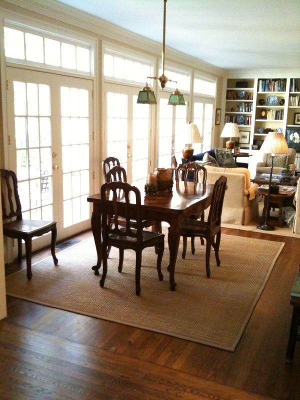

Our family room in our last house was 14.5 x 22. It was a wonderful size. It was set up much like yours, but the fireplace was centered on the wall. We had slightly more room than you but here is what we had. . .
Den, Uploaded with Snapbucket
I would center the fireplace on the wall - absolutely. The off center fireplace would bug me incessantly and would be very difficult to decorate around. If you can't fit a double french door, put a single. Put a large window on the other side. Have corresponding transoms on both (this is like ours and I am a symmetry nut but it never bothered me).
I am attaching a link to our old house, which sold, but I think the pictures are still online. There are some ariel views of the family room. We were able to fit two very large leather club chairs, an ottoman, a sofa, a club chair and a bench, plus two extra benches beside the TV armoire. We could comfortably seat 8 in there and 10 in a pinch!
You will have to flip through the real estate pics to see but maybe that will help you with furniture arrangement.
FYI the passageway between the right bench by the armoire to the table is 24". Minimum recommended distance is 22". That was our main passageway into the master bedroom and it didn't feel tight at all.

This is a terrible picture but you can see the club chairs with a small table in between on either side of the sofa. The one closest to the table has a floor lamp in front of it, the other does not. I think you have room for this on the kitchen side. You could do the same fabric as the sofa on the club chairs.
