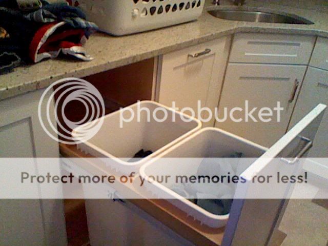

    Laundry room upstairs--I'm guessing that's a counter next to the W/D? How big is the sink you're planning to use? I would shift the W/D down to where the sink is and run a counter from the end of the W/D to the corner and then down across under the window. I'd put the sink next to the W/D with a sink base cabinet and hanging space above then I'd put pullout hampers along the short wall like these:
    Reasoning--that's a small space and as the kids get older, the laundry only gets worse. Having an efficient space that easily allows for sorting and storing the dirties, as well as allowing for plenty of folding and hanging space will help keep the laundry (and potentially the rest of your house when it comes to laundry) neater & more organized.
