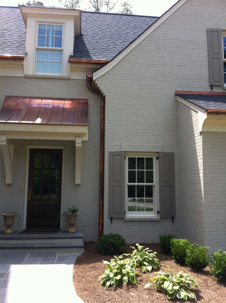

I prefer half round gutters with round downspouts. I don't know that I would pay extra for copper and do the crimped gutters (I am sure they have a name). With a dark brick I think a bronze half round gutter with round downspouts would be fine.
Here is our friends porch entrance. The roof is real copper and so are the downspouts, and the half round gutters are plated copper. They all look the same. The gutters are very splotchy right now from handprints from installation but they will age fairly quickly to a more uniform color, or so I am told. . .
Uploaded with Snapbucket
RE: Copper downspouts only on the front of the house?
that's beautiful, athensmom! i'm checking to see what our shape options are.
