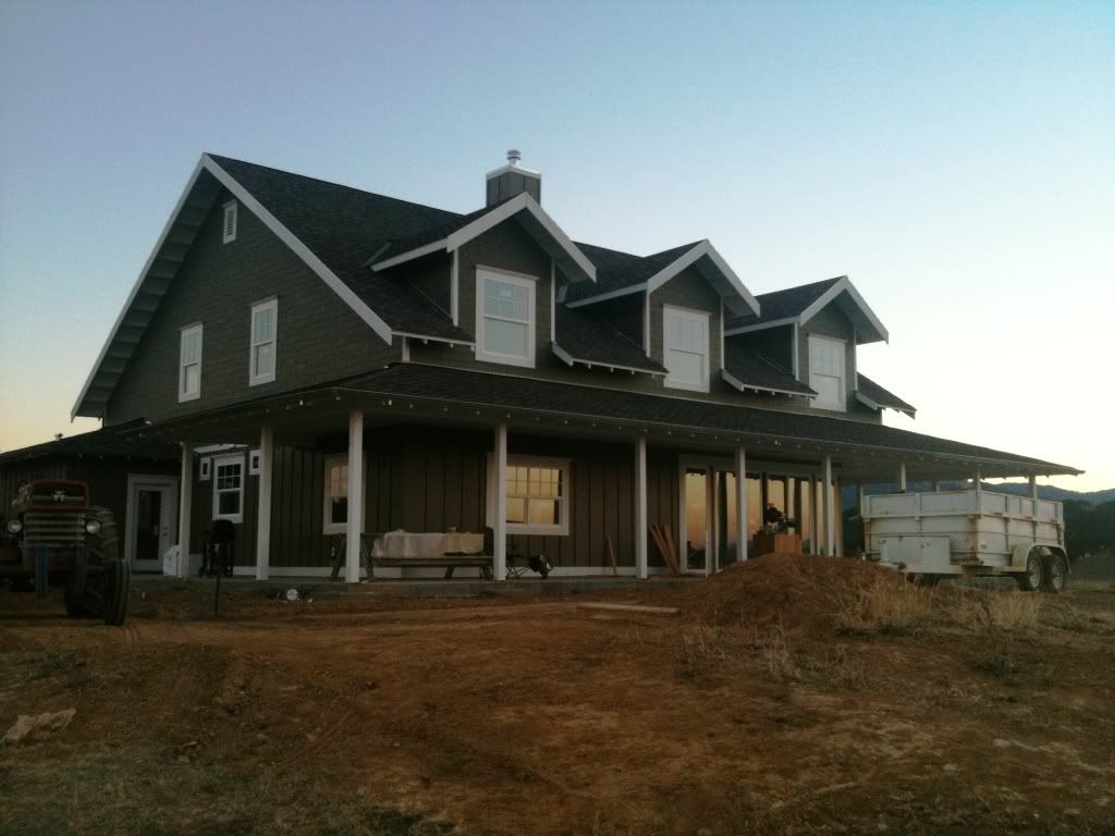

We're in the process of building a farmhouse style house with a wrap around porch. It's not exactly the same as the house you are building, but I'll post some pictures and maybe it will give you some ideas regarding trim details and such.

rhreinhard, that is a beautiful house! wow!! Here is the link to my field of dreams. It still isn't finished! :-)

We are just completing the Field of Dreams Farmhouse. We are building on a raised foundation due to a high water table and are building the first floor all on one level instead of dropping the mudroom down a notch. We mirrored the plan and added 4ft to the library toward the mudroom and added 4 ft to the guest and Master bedrooms toward the mudroom. The laundry we moved upstairs and bumped out 4 ft toward the bedroom. We stole the closet from bedroom 3 and used it as the Master Bath shower, built a toilet room in the middle, made the walk in closet a tub/spa room and put the walk in closet where the tub, toilet and shower were. A 72in vanity occupies the long wall against the laundry room. Here is a link to our pictures so far.
Here is a link that might be useful: Our Field of Dreams Farmhouse

Thanks for sharing! Where is that beautiful setting? I'm kind of curious about the orientation of your house. The first pictures you show are of the "back" of the house, but is that the side that you will see the most from outside? The front door is facing the trees with a smaller front yard. It seems like a smaller perspective of the house. We're thinking about doing this house or a variation and I keep thinking about the front as the back and vice versa because our front would be of the trees and the back would be a wide open field.
