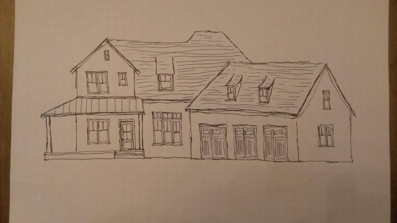

If you are set on not touching the floor plan much at all, I'd consider your best bet being to simplify by doing a few changes: Pull the window above the front door forward and combine the "gable within gable" to be just the larger gable. Turn the dormer above the dining room into one with a shed roof instead of a gable roof. Square-out the garage by removing the bump-out on the side wall and making a gable above it instead of the hip roof, and square out the front by making a continuous wall with three separate garage doors, either keeping the gable above or switching it out for two shed dormers. Definitely remove the awning-like structures. I'd also remove the gable of the porch above the front door, as you can bring prominence to it through the columns and landscaping. Simpler shapes with better materials will give the house enough character, the overly complex details are unnecessary. Good luck!

I didn't see the revised version which included a couple of my comments! In any case, here's a sketch of what I was suggesting, which the only finished space that should be effected is the upstairs bath. You could bring it forward, have a slightly larger vanity, and included the linen closet inside the bathroom. Perhaps turn the current linen closet into bookshelves, a regular closet, or access to storage in the attic spaces.

mvjc, You're the best! I can't tell you how helpful this is!!
