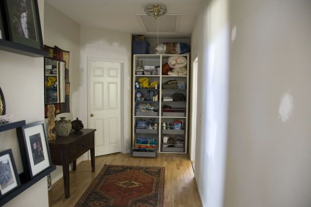

We used IKEA kitchen cabinets in our laundry room. We also used the kitchen cabinets to make a built in hall closet (pictured below). As you can see - it is not finished (the whole house is a fixer). DH still needs to add the boxes on top, trim on sides, and of course the doors and drawer fronts. It may not be obvious, but the 5 shelves on both sides are IKEA drawers. The bottom 2 on both sides will have regular drawer fronts and the rest will be behind doors. I love all the drawers - these allow me to utilize the entire space while keeping everything easily accessible.
When the time comes, we will use IKEA for our upscale kitchen - reno planned for next spring.
We will be getting custom doors & drawers for all of this because we want the white painted shaker style doors and IKEA does not have those.
We did an IKEA kitchen in our last house and loved it.
