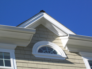

We used HardiShingles and love them! The lumber yard where we bought our HardiShingles got them pre-painted by a company called Weiss, which gives a 25-year warranty on the paint. They have lots of colors to pick from, or do custom colors. We had no problem with damage to paint during installation (zero touch-up needed); but admittedly we have a very careful builder.
We also bought matching caulk and a couple extra gallons of paint, 'just in case.' Except for decorative pieces, we trimmed with Azak. We used some of the extra paint for some Azak on which we mounted exterior lights, and it blends with the adjacent shingles perfectly. Low maintenance is our goal! We're very happy we went this route.
HardiShingles - Weiss pre-paint
HardiShingles - Azak Trim
