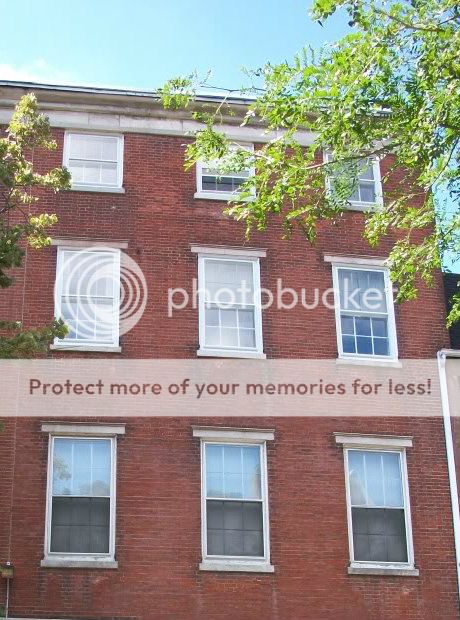

| My house is a much different style than yours but here's what one set of front windows looks like with brick. |

| Personally I think it will look fine. Your architects elevation drawing looks very similar to the other photos posted (the *do* photos) and they all look great. The historic look you are going for is definitely there. |

| I think what you are going to end up with looks a lot like what we have here historically except for the sill: we have the partial brick exposure, with a thin frame appearance on most of the Geo/Fed/Greek buildings here except for the vernacular workers houses which may have very thick casings. I think the solid sill will help the illusion. |
