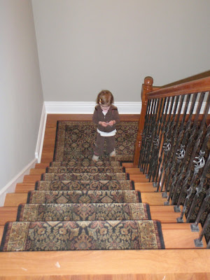

Wildcat, we are currently planning to do the very same thing you are...wood endcaps (risers?) and the iron spindles on one side, carpet going to the wall (there will be a wood trim piece going up the side of that wall to give a feeling of an additional cap).
And you mentioned the one issue that's had me going back to this again and again...once carpeted, always carpeted. I'm thinking I may want the wood stairs to be there after the kids are bigger.
Everyone's thoughts are great! So glad for all the feedback. Mairin, your stairs and runner are lovely, BTW. I'm leaning toward doing all wood and seeing how we do with them; it seems a lot of homes in the area are doing the full wood stairs, anyway.
