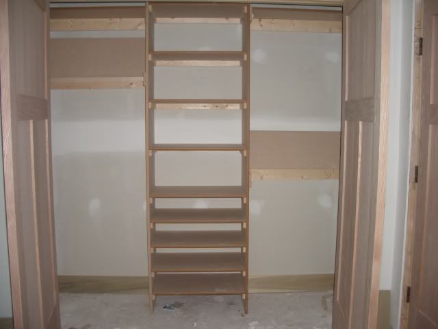

I definately prefer the 6x6 closet for kids. Our kids bedrooms have closets about this size and I like that combination of shelving and hanging space, plus the additional benefit of being able to pitch "stuff" in on the closet floor and pull the door closed in case of an emergency visitor. The other advantage in my mind is that you don't have so much wall space in the room devoted to the double or bifold doors. In our guest room, we did end up with a reach in closet, which also provides a lot of storage, but some how, the boys closets just feel "better" to me. Here are a couple of pics.
Small walk in closet
Extra "toy" closet
Reach in closet
