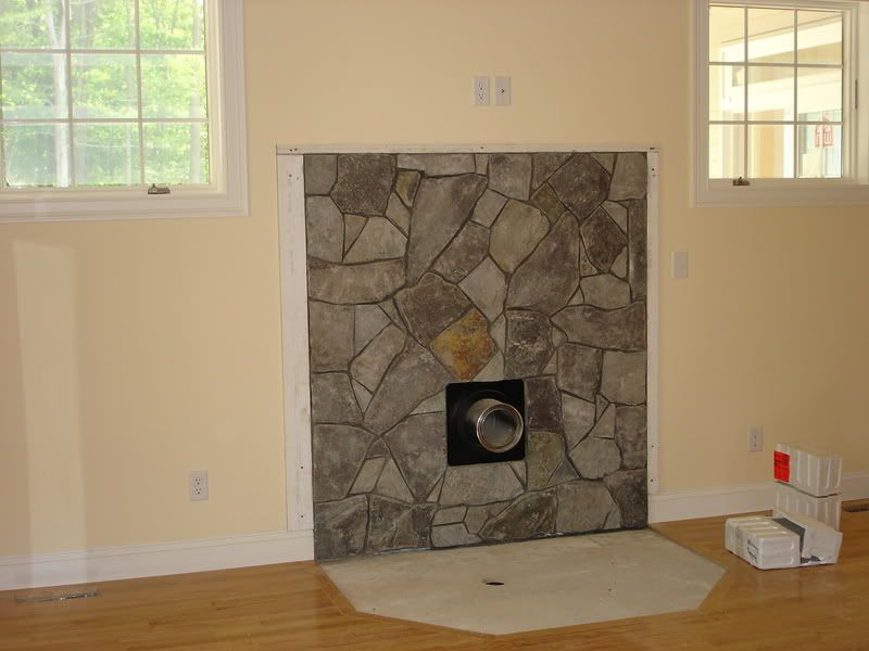

  • oruboris
    16 years ago
    I find it odd that [in as much as you can tell from a website photo] the 'natural' veneer doesn't look as natural as the better fakes...
    real:
    {{gwi:1456072}}
    Owens corning 'cultured stone'
    {{gwi:1456073}}
    Can't show you the El Dorado: their images aren't compatible.

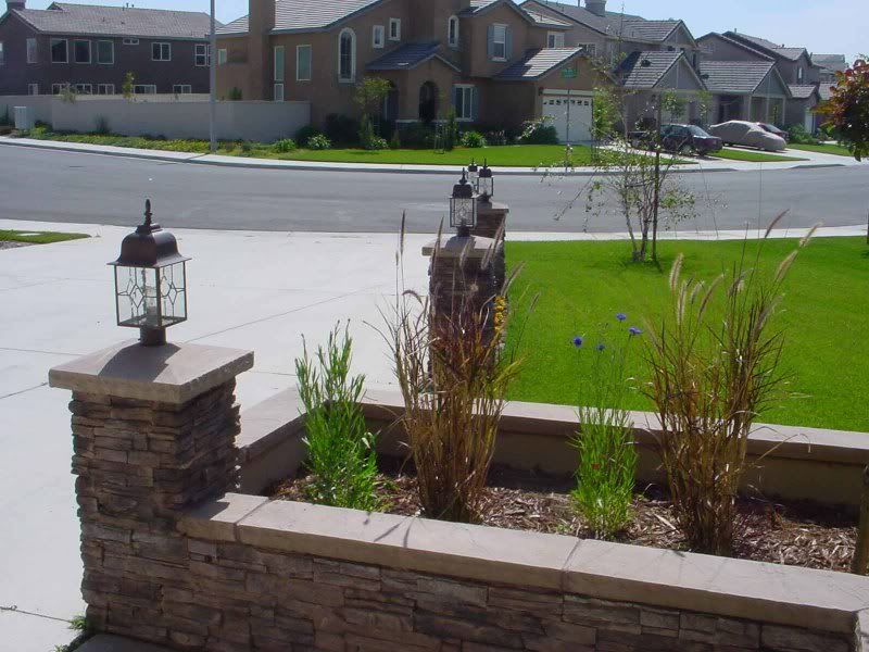

    16 years ago
    We used Eldorado stone on our outdoor fireplace in our California home and for our wall around our front garden. We liked it so much that we will use it again for retaining walls and fireplaces in our new home.
    Here is a photo of the fireplace. It was the Rustic Ledge profile in the color Durango:
    almost finished:
    complete:
    We also used Eldorado Stone for our front retaining wall and light posts. We opted for one that was easier to install, the Stacked Stone profile in the Santa Fe color.
    My husband did all of the installation and it wasn't hard.
    here are pics of the retaining wall, both in progress and completed:
