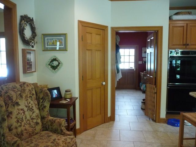

I can tell an MDF door whether painted or stained in a heartbeat. I'm old fashioned I guess but I think a door should be made of wood.... solid wood not hollow core. They just feel right to me!
In our previous house we used solid wood doors that were really nothing special just stain grade solid pine) after 27 years of a crazy active life raising 4 sons every door in the house looked, felt and swung as good as the day they were installed.
Here's a photo that includes what was perhaps the most used/abused door in the house .... the corner pantry! Those of you with sons can imagine how much use this door saw with 4 teenage sons at once in the house! :)
Anyway here it is.. original stain and all after 27 years of constant swinging and being knocked into. No one can convince me that MDF door would have held up as well and still looked as good so we're going with wood in the new house.... no reason not to.
