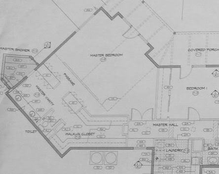

    swampwiz had commented on this from our prelim drawings. Our current house has a fabulous WIC off the bath but in another direction, the toilet has its own room which is perfect. the corner tub and large his/hers vanities on each side of tub and a seperate shower with a ton of floor space in t he center.. needless to say we spoiled.
    in the new house I like the idea of the WIC open with a window which puts it on an outer wall but totally agree that i do not like the idea of the toilet just in the open HOWEVER i cannot come up with ideas to rectify this, please help!!
    here is the prelim drawing
    Here is a link that might be useful: bathroom dilema layout

    crazyone-
    If you cannot add more space and you could live with 2 reach in closets vs the walk in...
    then you could put a closet on either side of the bath-where the vanity and tub are now, creating a hall to the bath and just moving the vanity and tub down and have the toilet and shower share a room with a pocket door at the end with the window in that space.
  • 2ajsmama
    14 years ago
    You could put a closet (wide reach-in) where the tub is now, put the toilet (with a door opening out if it's wide enough) where the shower is. I would leave the sinks app. where they are (take down wall where toilet is now and extend the vanity area to have a seating area, maybe b/t 2 sinks, for makeup) and that makes the space closest to BR a dressing/grooming area. Or leave the sinks as-is and make current toilet alcove a "his" closet and the larger (where tub is) area a "hers" closet. Or do what PP said and make his/hers closets where tub and vanity area now, then his/hers vanities where shower and toilet are now, but then you need to find a space to fit the toilet (compartment in what is now WIC?).
    Past the pocket door (you could even take this out and leave it open) in what is now the WIC I would put tub under window (with blinds or frosted glass for privacy), shower in corner (and toilet in another corner if you can enclose it and have turned other area into closet or vanity as in previous paragraph), or if you want a huge walkin shower I've even seen them where the whole room is a shower and a clawfoot tub sits *within* the shower area. Even if you don't turn the whole WIC into a WIS (walkin shower) you could tile that room/area but have BR flooring (carpet or HW) extend into the dressing area.
    I would also square off the BR next to it and put in a long reach-in closet instead of a corner WIC in that room.
    Sorry to throw so many ideas at you, but w/o knowing your morning routine, the dimensions, and how many clothes you and DH own, it's hard to make recommendations.

    My bathroom and closet curve so I never could get a decent picture of the whole thing. Here's the plans which will give you an idea of what I've been trying to explain (probably not so well) LOL
    The shower is the triangle on the far left outer wall, then the 2 sinks followed by the WC then a curve and finally the long closet. You can see the end of the hall where it meets the closet on the right side of the plans (just before the bedroom entrance door).
    To enter the bathroom just in front of the two sinks are two cupboards that open from either side. In front of those is a false wall that opens on either side and allows passage into the bedroom.
    Really confusing huh? LOL
