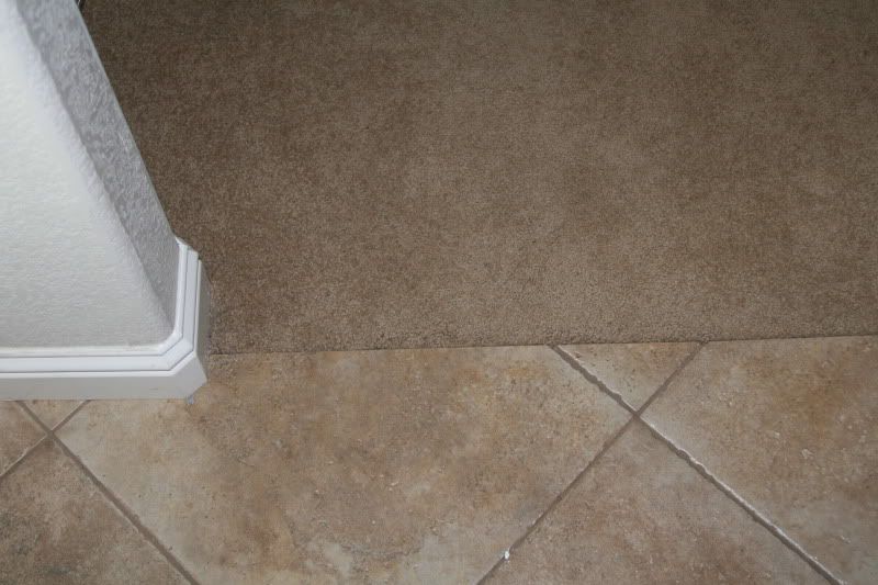

Actually, our hardwood floors are in plane with our tile floors and we don't have any transition moulding. There is just colored calking between the joint. And now that I think about it, our tile is in plane with our carpet as well and no transition moulding there either.
