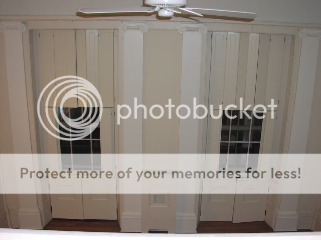

Here was my old apartment. This is Greek Revival, but look at the space between the top of the door and the ceiling.
The windowa (which were jibs) were much taller:

The door trim in that entry (of which I need to get a proper pic ) is genius, because the frieze board scallops in to allow the architrave to be narrower, avoiding that top-heavy look. The 1910 architect was well-known in DC and had experience designing large-scale Beax-Arts style buildings.

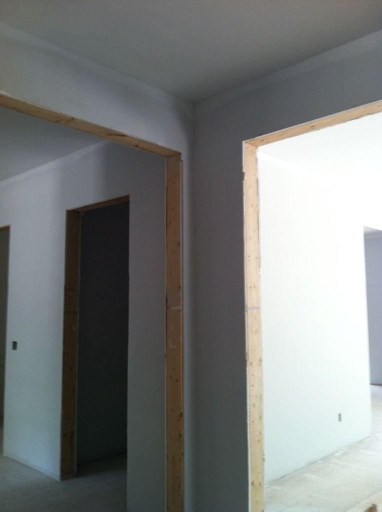

now, along the lines of lowering the opening in my family room, here is a photo of that opening taken from the foyer. this picture also shows what will be the cased opening in the hallway. the hallway cased openings should probably remain 9 ft even if the family room and dining room openings get lowered a foot, right? any thoughts on how i can do this so it doesn't look terrible? is it ok for hallway cased openings to be taller than door-less entrances to rooms?
by the way, the other doorway you're seeing in the hallway is a closet and then, beyond that, is the opening to the butler's pantry.

RE: Crown in family room leaves no room for door casing. Help!
I personally think 9' openings in a 10' ceiling are too tall. If you have 11' ceilings, the 9' would be appropriate. Otherwise, I would lower all to 8'
thanks, athensmom, i agree. what do you think about the opening into the hallway in the photo above? it's 9 ft. and is supposed to be some sort of cased opening. any idea?
I personally think it looks too tall. I also don't like how it is higher than the other opening (I assume those are doors?). I would have all openings the same height. Are the cased openings the only ones that are 9'?
Yes, the cases openings are the only ones 9 ft tall. We are going to lower all openings to 8 ft, but I can't decide what to do about the hallway openings. There is one at the end of that hall where the checkerboard marble will meet whatever flooring we choose for the mud hall. Any ideas what to do for these openings? Does their drywall jutting in (narrower opening compared to hallway width) make sense? That was the architect's design.
