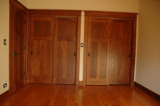

  • carolyn53562
    16 years ago
    I only have one bad picture showing our trim-I took this picture to show someone the dark color my son selected for his bedroom. Our window and trim is similar to your link, except we left the top molding off (our house has a contemporary edge to it so we were keeping things simple). You pay more for materials, but the labor is less with this style of trim because there are no mitre joints, so it balances out I think. Tell your finish carpenter that our finish carpenter said it was easier to install than typical picture frame trim, however there is a lot more wood to stain and finish, so that part gets more expensive. Good luck.

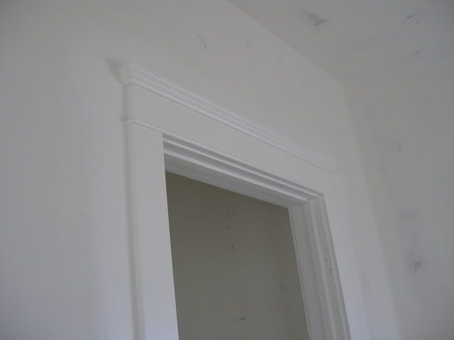

  • kats
    16 years ago
    I have a couple recent pics and one before paint. We decided on a very plain trim to offset the many curves in our home. It's all white and I love it.
    Here's our dining nook just off my island...
    Here's our GR...
    Here's a close-up of a door prior to painting...

  • kats
    16 years ago
    jamielo,
    Thank you. Yes we are leaving the doors and jambs stained like that with the white painted trim. The 9 lites are on the outside of the dual pane glass so we could paint or stain. They're white on the exterior and a custom stain (shown in my pic) on the interior walls.
  • carolyn53562
    16 years ago
    rhome-the baseboards in my picture are 1 x 6, and I now wish that we had gone with 1 x 8. The trim around our windows is 1 x 4. We did all of our windows as individual windows so that we could use 1 x 6 trim between the windows. You can see the effect of this look when you compare our windows to brianwhite's windows. We left the top of our baseboards flat. I like the look of the square top baseboards, but it does collect dust quicker than a rounded top. Brianwhite--beautiful house!!!

  • fishpants
    16 years ago
    Kats-your place is SO nice looking! I bet you are starting to breathe a little easier knowing that there really is a light at the end of that tunnel. Your trim is exactly what I am planning on doing in ours!
    Jaymielo-I know that there are some companies that make an 'architrave' moulding that is one piece and looks similar to kats' setup. That's the route we are going, and it really isn't that expensive, all things considered.
