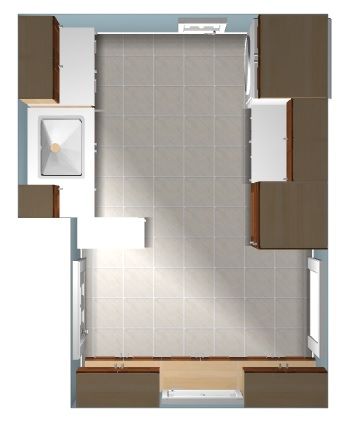

Hi!
We just realized our laundry room is super small and that we need to open and combine it with our mudroom.
First drawing is the split room by architect, Second post will follow - it's my chicken scratch attempt to re-draw as a laundry/mudroom combo. The link is a photo from houzz which is our inspiration to combine laundry and mudroom.
In the island or shelves area, I thought we could hIde hampers, or maybe in pull out cabinets (similar to trash pullouts) on the other side to the left of the sink. By the way, the pic is blurry but the small cabinet beside the possible island reads "Broom Closet" which we really need!
It still feels soooo tight! Any suggestions?

And here is my chicken scratch attempt to combine the two rooms. Any comments would be extremely helpful! TIA!!

In a laundry this size, so many times the space is not used as efficiently as it could be. The space available in the laundry room in the revised drawing is deceiving--there is less than 2' between the island counter and the sink counter as drawn--not very feasible--3' should be the minimum with 3.5-4' being ideal. Here are 2 other options to consider. Since you changed the W/D to a stacked set in your drawing, I took the liberty of continuing that theme to give you more counter/hamper/broom closet space.
A side note for the pullout hampers you want--we have 3 full counter height double pullout hampers and love them. You will need to make sure you spec 'full counter height', 'double' and 'trash pull-outs' otherwise your cabinet guy will likely order true pull out hampers which are singles or 2 very skinny wire baskets side by side left to right (vs. front to back), with a drawer above that only hold 1-2 changes of clothes.
Using the original door placement:
Sliding the door down & making it a pocket door (you may need to bump the mudroom entry door from the garage back out flush with the laundry room wall):
I really like the original mudroom and think it will look fabulous with the window framed by the cubbies--I'd be very reluctant to change that. It's not often someone has a mudroom they can say looks pretty :-)
Hope this helps!

Back again! Met with our carpenter... And he came up with the following scenario. It's a combined Laundry/Mudroom similar to geokid's last drawing, but with a 36"x24" island with canvas canvas roll out hampers underneath (open to the back). Great place for setting laundry basket, dropping things when you come in,etc. - keeping that open feel. I will be folding laundry in the great room because I like to keep an eye on the kids, so 36" drop zone countertop is plenty for me. I'd love for the island to come right up to the garage door so that we can have the 12" lower cab to the left of the sink instead of a blind front, plus easier access to the upper cab which is complicated by the island placement. But I don't think the on-site measurements will allow for the island to shift - we shall see.
We reclaimed the right wall for a 24"x24" full height utility closet and six 12" wide - 16" deep cubbies (probably will not have full length dividers and instead just one continuous bench). I think there is 35 1/2" walk space between the island and cubbies so not too shabby. We are removing the pocket door system (to allow for the millwork and cabinetry on that wall) and going back to the original architect's suggestion for a casement opening. We could always add a door later if needed - but I think the way we moved the doors obscures the breakfast room and kitchen view to the laundry/mudroom nicely. The two windows and doorways are now symmetrical, which is pleasing to the eye.
Of course I lost upper cabinetry with this floor plan so it gives me some heartburn, but I think I get a visually open feel and more room for 6 people's traffic, junk and laundry which we really need so it's a tradeoff. I'd like to figure out some uppers on the W/D-sink side of the room and a hanging bar. Anyone want to take a stab at elevations? Also, does anyone know if I can recess an ironing board cabinet on the exterior wall between the window and the W/D?
What do you all think?

Here are a few drawings:
Your current plan. Cabinets above the "cubbies."
A combo of your plan and your architect's original plan. On the right is a utility closet, a stretch of cabinets and counter, and a cabinet facing the cubby area. This can be open or closed or two more cubbies.
Just like above but with a half wall on the left instead of a cabinet.
Another version. This one with the utility closet closer to the doorway.
Sink and W/D on opposite sides of laundry room.
