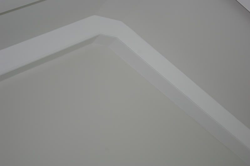

Ok, I am going to try to help...I have a 16x17 master with 10' ceilings and a vault which seems to me, almost too high. Our master is on the ground floor, but it is in a wing with no second floor above. In the plans, it was drawn with a 10' coffered ceiling. Dh decided that we should take advantage of the fact that there was nothing above and vault the ceiling ALL the way up. Wow. I don't know the exact height and dh is out of town, so I can't ask him...but it is so high. I think the pitch would have been fine in a larger room, like the family room...but it definitely does not make for a cozy master. And, not sure what your flooring will be, but hardwoods plus nosebleed ceiling=echo, major echo. Not the best thing for your master, if you catch my drift. I have one pic in photo bucket, but doesn't show the top. I will take one tomorrow.

This is a narrow pic that I already had...I never got around to taking a new pic today, hopefully tomorrow. Dh thinks it might be a 7:10? Is that such a thing? It matches the pitch of the roofline on the outside of this rear wing of the house.
Room dimensions: 16x17
Ceiling height 10'
This pic is very narrow, and I don't think you can see the top...but maybe it will give you an idea til I can take another.
Here's another view:
I looked at those other pics posted, and those rooms are much larger than ours. I think you have to keep scale in mind, ceilings seem taller in smaller rooms. My 10'ft tall powder room seems like an elevator shaft! :)

Walls are definitely 10 ft tall and vault rises from there. Our entire 1st floor is 10 ft ceilings. Our bed is really tall, plus I think this angle is funny...maybe it looks lower in the photo? When we rented a house with 8 ft ceilings during our build...the tops of the bed posts almost touched the ceiling! It is hard to get a feeling for how tall that vaulted ceiling feels from a photo...it has a nice look, but I really think I would have liked it better with a coffered ceiling.
Some more pics
I just tried to take a couple of photos so you could see the top...I don't have my friend's wide angle lens so not sure these are even helpful... I spent a lot of time looking at the beams to see how tall they are...and 7' on each side of the peak really does seem like the best guesstimate. So it is a wider angle and a less steep pitch than some.
