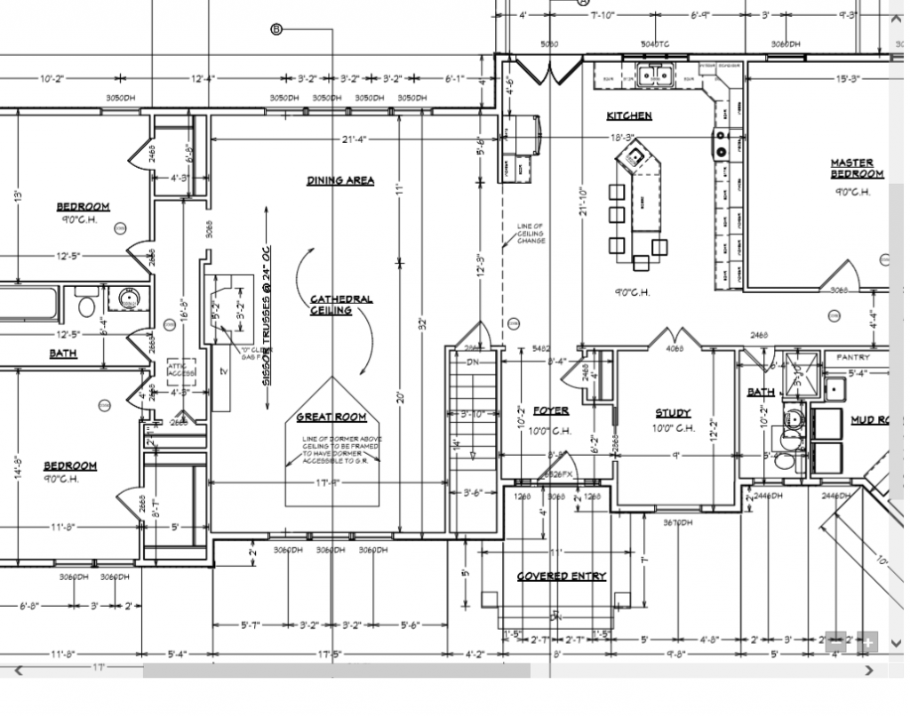

Hi everyone,
I'd love your thoughts on the pros/cons of an open staircase and if its a good idea to have one in my plan. My builder suggested it because I want wood beams in our vaulted ceiling, and the open stairs would give symmetry between the dining area and living area, since we have a dormer we have to 'beam around'.
The nice part of the open stairs would be that 'open feel' plus we may have a wood stove in the basement some day, so open stairs will help bring up the heat. On the con side, having the full wall would make the room a more defined space, and allow better furniture arranging (I think). Plus, there would need to be a door at the bottom of the stairs in the basement, for noise control, instead of at the top.
Thoughts?
P.S.- the stairs would only be open (with rails) on the great room side- there would be a wall on the foyer side..

Renovator, the ceiling will be vaulted with the peak in the center of the room between the dining room and the living room. I think you a correct that if we remove the wall, then the dormer should also move to the right to be centered.
Also, that version of the plan is outdated- will update another version later...very little differences, its just that the staircase no longer juts out into the aisle, but the great room was bumped out to the front about 2 ft to accommodate that. The staircase door in the final plan lines up exactly with the aisle.
Hough, do you have a door at the bottom of the basement stairs? I need a door somewhere to block noise from the basement.
Another con to opening it up is that I was planning on a closet at the 'top of the stairs' in the corner of the living room- I think I would have to loose that right?

Below is the accurate floor plan. With the open stairs setup, will I be able to have a closet above the basement stair landing (right hand corner of great room in the front of the house). If I do have the closet, will that 'mess up' lining up the windows with the newly opened up room (right now the windows (and dormer) are centered based on the stair wall being there- centered on 17ft, with the open stairs, the idea was to center the windows based on the 21 ft width of the full room... not sure if having the closet there throws that off.
