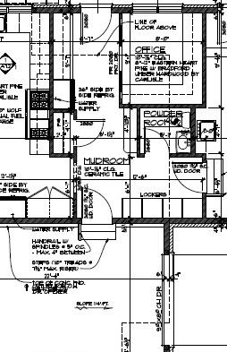

  • pps7
    14 years ago
    macv, I don't have the electrical plan in pdf format. Here's a picture from my cell phone, I hope it came out.
    The joists run up and down. There's a joist right where those 2 cans are drawn. That door at the top of the picture leads to the covered patio and the backyard. I was thinking of putting in a fixture right by that door and then moving the can down below to the right so it's centered on the larger space. Then the question becomes do we need a separate switch? There is very limited amount of wall spaces for switches by the back door.
  • macv
    14 years ago
    Wherever the joists are I would not locate the recessed fixtures where they are shown and they too far apart for them to need to align with each other. I mean no offense to anyone but you are thinking too much like an electrician and providing general lighting on the floor of open spaces (they seem to love to do that for some reason).
    I would move the light nearest to the door closer to the task area behind the door (a bench?) and maybe it should be a wall-washer.
    I would move the light at the other end of that hall closer to the task area that looks like a small counter and maybe it should be a wall-washer as well.
    I would put the third light centered on the cubbies (if that's what they are) and make it a wall-washer for sure (perhaps two).
    Only after the task areas and walls are illuminated would I think about general illumination since light bounces off of walls rather effectively. In this case, I don't think additional light is necessary. However, I don't have any idea what the fixtures and lamps are.
    In the office I would definitely not put a light in the center of the room since it would be shining on the back of your head when you were working at the desk. I would put several smaller recessed lights on the walls over the desk or on the desk itself and add a dimmer.
    I've never had much success with double pocket doors and it messes up the switching.
    I don't see any lights over the kitchen counters; I hope they aren't shining on the floor behind the cooks. There is no more important place for task lighting than a kitchen work counter especially the sink which deserves two fixtures to avoid shadows.
