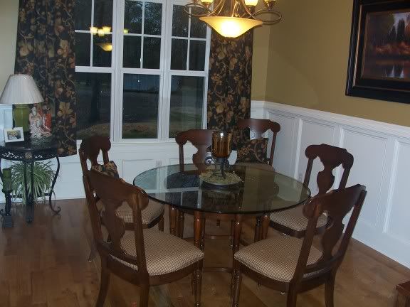

    Kate...Will you have any other furniture in the room besides the table & chairs? I don't know that it would be much help, but our dining room is 11 1/2' wide and 15' long. We have a 54" round table with seating for 6 and a sideboard. I allowed 54" for the table, 18" for each chair (3' total) and 36" for the aisles around the sides so there is plenty of room to pull the chairs out while they're in use. Will you be using the doors daily? I think you should comfortably have room for inswings if they're used infrequently, but I'd probably opt for outswing if they'll be used often.
    Here's a pic. The room dimensions are similar, so hopefully it can give you an idea of what a 54" table would like like in your room. Pretend the windows are french doors. LOL There is a 48" walkway between the windows & the backs of the chairs. Remember though that our room is about 1 1/2' longer though! I still have to find a rug & finish the panels for the windows. No laughing! :o)
