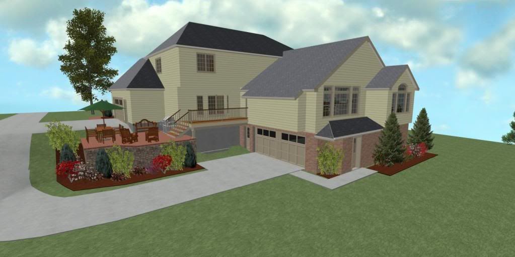

  • bigkahuna
    14 years ago
    Some do both....well in this addition I am adding it worked best to add below under the new Fam Rm, Kitchen, Dinette.
